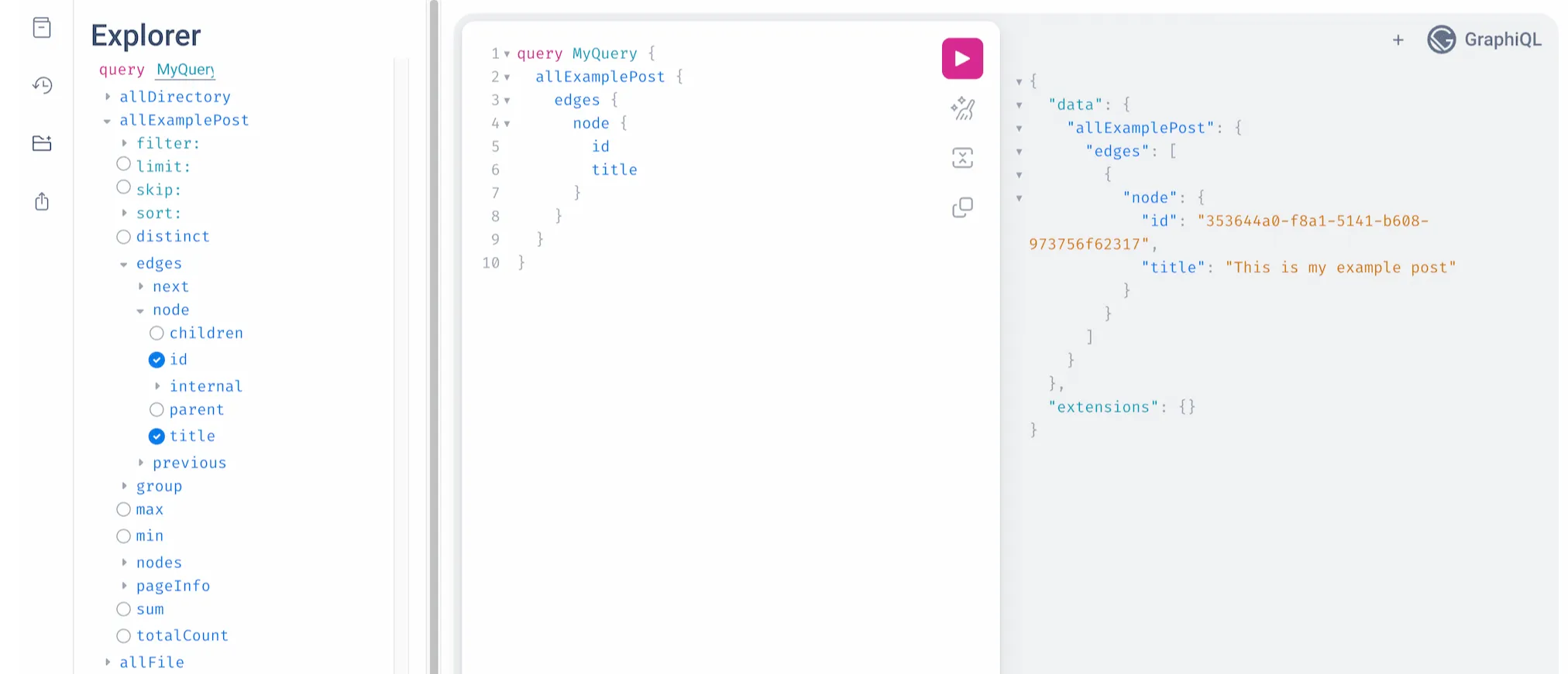

For example, if you start local development with the example code that’s documented in the develop your connector section above, you can run a query for the id and title of allExamplePost in the GraphiQL UI and the local server will return the data we created. Note that Netlify makes the ID globally unique.
Example query in a local GraphiQL UI
