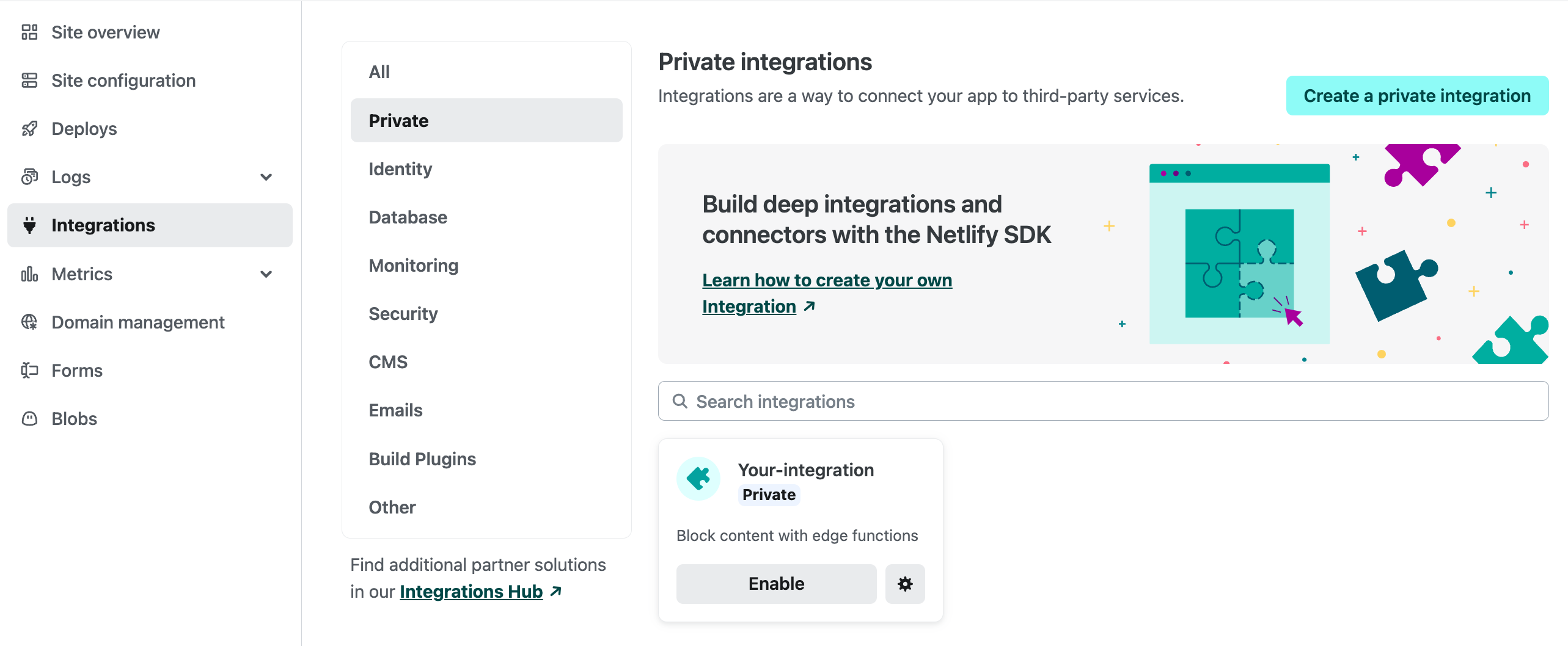

You have a working integration now! Let’s try it out by deploying your integration as a private integration.
Now that you’ve created your private integration, let’s try it out on one of your Netlify sites! You can test it out by finding a site in your Netlify account (make a simple test site if necessary). When you’re in the dashboard of that site, select ‘integrations’ in the site’s sidebar. Then, find your integration in the list of private integrations. The last step is to click ‘enable’ on the integration card.
You can test it out by redeploying your site and then visiting your site on the /test path. You should see the message “Hello, world!“.
